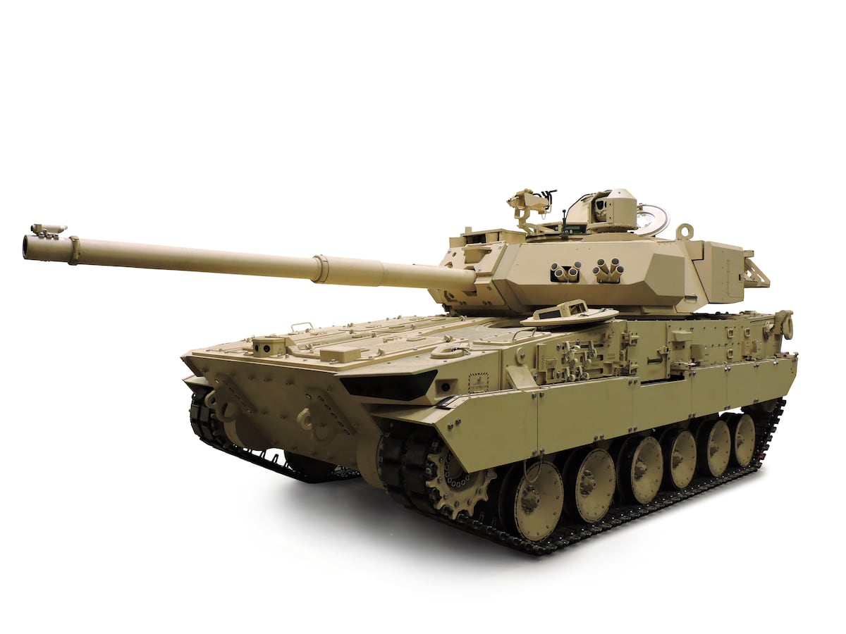

How about a 'light formation' with airportable tanks/ MPF?
Light tank prototypes arrive at Fort Bragg for soldier evaluation​
BAE’s MPF prototype can be transported via a C-130 aircraft. Three can fit on a C-17 aircraft. The Army is requiring the vehicle be C-17 transportable.
