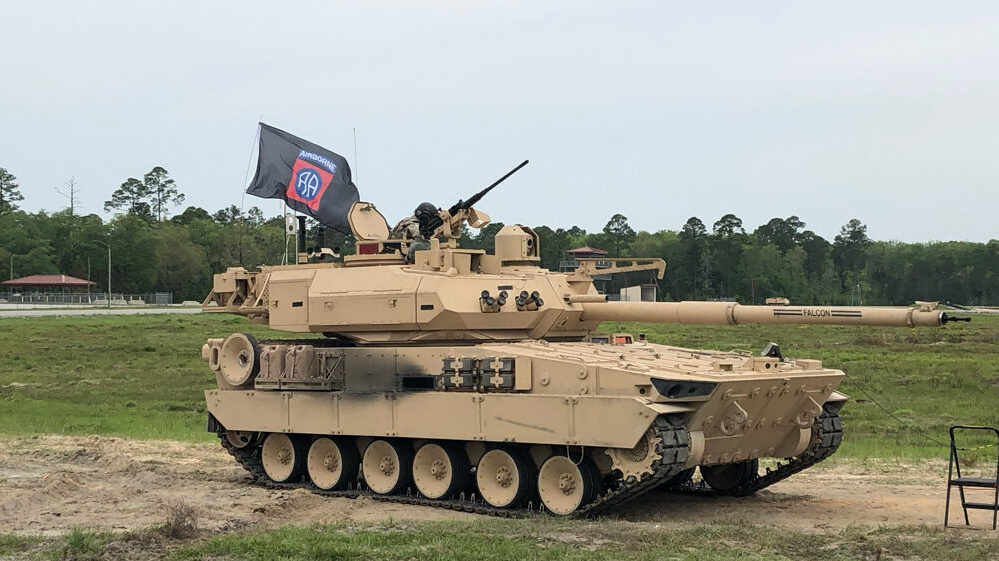

Well the winner of the light tank in tbe US.....drum roll please GDLS!
Maybe an interesting idea for Canada?
Atleast the winner is GDLS....ITB will not be a problem if CA goes this way. But as I pointed out in a snarky way elsewhere....let's buy the Euro one. :)
I have read we have our eye on this project, after all we have Cavalry Regiments now too ;)
Where have you read this? I would love to read this as well... lol
I'm not seeing how useful that it would be for a cavalry regiment myself, as the gun is really for infantry fire support.
Read it on the DWAN, related to F2025
