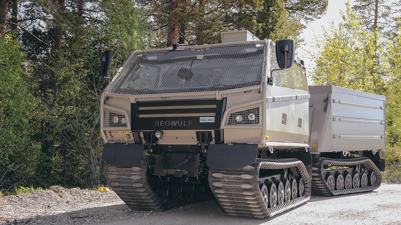

For our Northlands (70% of the country) tracks make more sense than wheels. Mobility trumps everything. Firepower is more important than protection.
The other Northerners, who actually live in their Norths and are facing a "live" enemy are fielding forces with a few tanks (Leopards), CV90s and lots of Bandvagns. As well as strong coastal fleets of small boats.
We don't actually face a live threat, at least not on the ground, but at very least we should have the ability to move over our own ground and be able to provide fire support to whatever troops we deploy up there.
The LAVs will work great in the farmlands accessible by highway. They could benefit from a tracked force to assist when the going gets hard. The tracked force could also find utility overseas AND domestically.
The key issue in deployability is weight. Tanks, although well protected, are heavy. One MBT weighs the same as 2-3 CV90s or 8 BvS10s. Or 2 LAVs.
A key element for any Canadian force then, IMO, is the ability to deploy light and then uparmour when the situation demands.
Out of all of this I find myself wondering if the LAVs shouldn't be left to the Infantry and the Artillery while the RCAC moves to a combination of the CV90 FOV and an LUV force.

1) I have a tough time envisioning a situation where we would be deploying MBTs or CV-90s domestically. As you stated above "We don't actually face a live threat, at least not on the ground" so to my mind having a specific capability to meet what is admittedly a non-existent threat doesn't make any sense. Given the size of our North air mobility and light vehicles (e.g. BvS10's) make much more sense as an investment in Arctic domestic security than AFVs
I agree. My point is that CV90s, without the plussed up armour would be easier to move into our North if the unlikely ever happened. And the fact that we could get support up there probably makes the unlikely even less likely - which is no bad thing.
In the meantime CV90s could be seen as an adjunct to our expeditionary offerings, operating alongside or instead of our LAVs.
Twofer.
2) In light of the RCN shipbuilding plan, F-35's, NORAD recapitalization and investment in key missing capabilities like GBAD, ATGMs, Artillery, UAVs, etc. I simply don't believe (despite what I personally might wish) that the GOC will purchase a new fleet of tracked IFVs. They MAY be pressured politically by the US/public opinion into either upgrading or replacing our MBT fleet, but that is likely all. I'd be willing to bet significantly that the CA will be a LAV-based fleet for the foreseeable future.
To be clear, this isn't the road forward that I'd like to see. It's simply what I believe will actually be the case. Given that reality, how does that affect the decisions that are to be made regarding future force restructuring?
I also agree with you here.
In reality I expect to see these before I see any CV90s or Bradleys.
