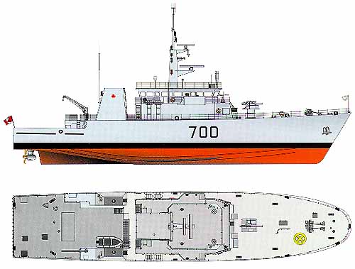

Plus US and Canadian CG have used helo's without hauldowns for decades. Very true it limits usage without it.
Is this, the RN's experiment a potential answer to shipborne aircraft for small combatants?
I know 14 feet is a lot of space on a small combatant, but the current Kingston class ships have fairly spacious decks, don't they? (That's a serious question for the sailors.)

When we tested the ScanEagle on the Glace Bay ~2010, the launcher, catcher took up the whole sweep deck (quarterdeck) of the MCDV.  The legs of the devices were criss-crossed as well, making it interesting to maneuver around them.  The units themselves were tied down with chain ties, (borrowed from the Toronto Helo Det if I remember correctly), and were done in the best manner possible.  So it basically looked like spider-men went nuts with chain webbing, as we did not have the optimal tie down points for the equipment.  The pod section was used as the control station for it, so basically one unit used pretty much occupied the whole aft end.  It didn't impede launching the rescue boat, but line handlers had to take more care when moving around at night due to the legs and chains on deck.
I remember speaking to the commodore at the time about further use of the drones and MCDV's.  His response was although it was viable, it would be more advantageous to deploy them from a frigate that could operate 4-6 at a time.
Thanks for that, but ... assuming that I'm right and that there is a valid operational requirement for a mixed, balanced fleet that includes several small combatants, say in the 1,500 ton range: is the UAV a suitable replacement for (not adjunct at) the helicopter?
(I know I'm "situating the appreciation," but I was in Ottawa for a long time so I learned that's how policy is made.)

Even on the MCDV's they would be a useful kit and could be accommodated on a smaller foot print, by moving the control station to the ops room or the bridge in a more permanent manner and using a smaller , container mounted launch rail. But in every case, you would have to trade in the capacity to carry out mine warfare. If you are going down on OP CARIBE, that is a fair trade in capability, but if you are going up North, you probably want the route survey/underwater detection gear capability at the same time as the Scan Eagles if you could (which you can't).
In a new 1500 tons + small combatant like the ones we all mentioned and put pics of above, the set up used by the Brits would work wonderfully as the launch ramp is wheel mounted to go in the hangar and just be rolled on the flight deck, and you can probably store three or four birds at the same time in the hangar easily.
I would be weary of leaving any of that gear exposed on the upper deck for long period of time (because sea salt spray plays havoc on airforce equipment).

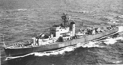

The initial corvette was a true desperation play: it was cheap, a proven design, cheap and easy to build, not too difficult to sail and even fight with an inadequately trained/experienced crew, and so on.  But, very early in the war, the admirals recognized that the design was deficient and most corvettes were refitted with a much longer fo'csle. Midway through the war it was appreciated that the corvette was too small, too slow, just plain "not good enough" and the frigate was built, starting in 1941. It offered the size, speed, and endurance required for mid ocean escort duties, while using the inexpensive, easy to operate, reciprocating machinery of corvettes.
          An original, short fo'csle corvette                        A refitted corvette with a long fo'csle                      A River class frigate, bigger and better than corvette
            In common use until 1942/43                                  In use until then end of the war                      In use from about 1943 onwards, and in peacetime, too
                                                        The evolution of the RCN's North Atlantic escort vessels from 1939 to 1945
The corvette was a useful vessel, but not good enough; but we had good, tough, admirals, especially Sir Max Horton in Liverpool (HQ of the Commander-in-Chief, Western Approaches) and Leonard W Murray in Halifax (HQ of the Commander-in-Chief, Canadian Northwest Atlantic) who knew what they needed and drove the engineering and procurement processes (thank all the gods for CD Howe!)* to get what they wanted in a timely manner.
