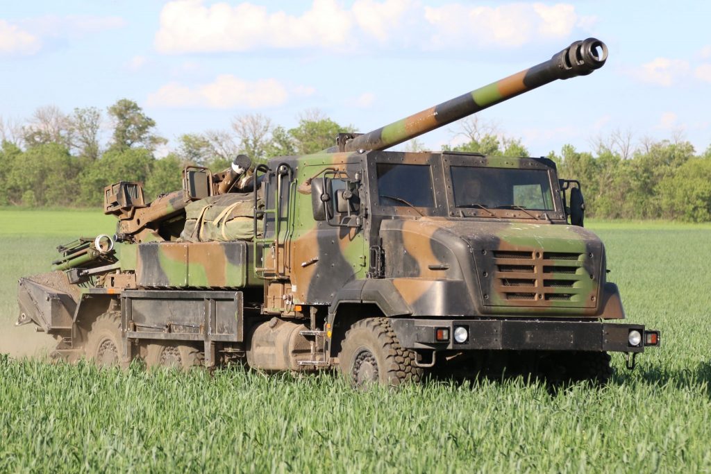

Unimog 2450L
12 tonnes. 100 km/h on road. Airportable in a CC-130
18 rounds on board. 6 Rounds per minute.
5 Crew - Exposed while firing. Limited ammunition capacity.
You've already identified the key issues about this gun as to why I'm not too fond of it, just for the fun of it let's talk about what I like.
It has a 155/L52 barrel and could be relatively easily adapted to an automated fire control system we already use.
It has a relatively decent automated assisted ammo handling system at the breach,
It's relatively inexpensive compared to some other offerings in this class.
It has a a good history of sales and deliveries (albeit there is a large backlog to work through)
They have a good track record of mounting the system on a variety of vehicles - which makes me think that we could develop a good SEV versions of the ACSV as both a gun carrier and as an ammo limber vehicle.
I still want to see a gun where the crew operates under armour rather than in the open and supported by a good limber vehicle.

I wonder how it would fare as a Reserve force staple with a good supply of those HVP AD rounds?
I don't have any info on any reserve units anywhere using Caesar but quite frankly if the US ARNG can handle M109A7s then I really don't see an issue so long as the appropriate arrangements are made for their maintenance and access for training (The old argument that our armouries are well made for marching infantry out the front door but little else. I paraded at Moss Park which was brand spanking new in 1966 and you could barely drive a deuce through the back door unless the tarp was in the low position.)
Ammo isn't a reserve issue. It's an army capability issue. What we stock, and how much of it, is very important but only interacts with reservists on the training side if there are specific special handling issues associated with it.
