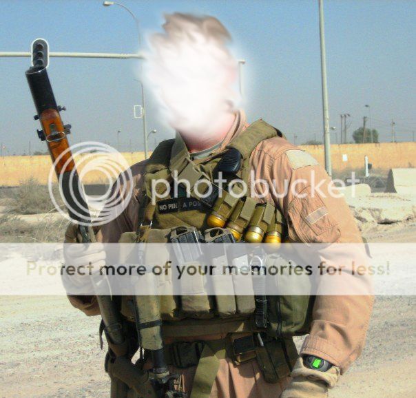

BigRed was using the TT Belt.
There is a thread on LF as to the how and why's of this.
Granted he had a Mk18 and a M79 - but the theory is the same for carriage.

Big Red said:
Looking good is half the battle!
Finally solving the riddle from GI Joe  8)
(refrence "Now you know!" "And knowing is the half the battle")
