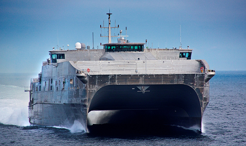

What happens to "small vessel" capacity (less than 1000 tonnes) if we were to produce SWATH or Catamaran platforms?
Catamaran = JHSV at 1500 tonnes (so a smaller scale version)
SWATH = SeaFighter at 950 tonnes
