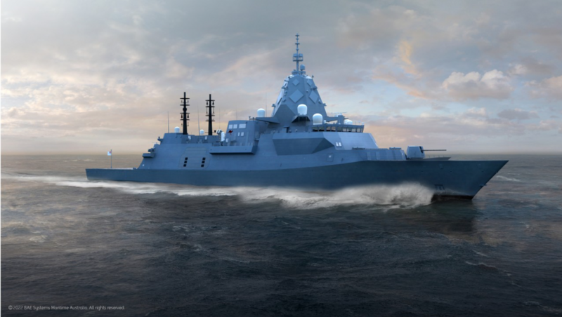

Interesting. This article suggests that in order to accommodate the extra weight, the Hunter class T26 variant will be 0.6 metres wider than the reference UK design. Could we expect a similar change in the CSC design?
I wouldn't think so we reduced the amount of VLS to 24 vice 32 and our radar and mast is not as heavy or tall.
according to wikipedia ours are a wee bit longer
Its also 2m longer. Hence why the Hunter class is 10000 tons and the CSC is 8800. It's going to impact them on top speed and endurance because they aren't changing the engineering plant.
It depends what type of displacement you are using for comparison. The Hunter figure you list is at full displacement while I am not familiar with the CSC figure. Kevin McCoy, former President of Irving Shipbuilding went on record early last year stating that CSC would likely have a full load displacement of roughly 9,400t. There has been quite a period since then, obviously we have seen design changes such as the ships mast configuration and the loss of Mark 41 cells however, that previous info points to the fact that CSC and Hunter likely aren't incredibly far off with regard to full displacement loads. It's to be seen though how both final designs stack up.
From open source published data for CSC is 8800, and for Hunter 10000. Its is larger because they needed the space for more VLS. That's a direct quote from an Town Hall where I asked about how Hunter class was able to fit in more VLS.
But you are completely correct in what displacement they are refering two, design margin, full load, nominal load, empty etc...

Anyone care to guess what this means for the first CSC? Also, assuming the above is accurate, looks like the Australians have also dropped the 32-cell Mk 41 (24 is reference in the article).
I didn't see anything in the article that said anything about he Hunter-class experiencing any new delays, and besides, at this point any delays are most likely going to be the result in a country's own internal procurement/production/contracting issues.
Ours is expected around that time as well according to the project timelines (perhaps 32 I'd have to look again). However everyone knows it will likely won't be fully operational until likely 2034.
And the drop to 24 VLS is a surprise, but not unexpected considering the Aussies are having a hell of a time with their enlarged hull (or so I've heard).
Edit: from the article...
The Hunter-class ships will have a 8,800-tonne full load displacement and will be approximately 150 metres long.
They will be equipped with an advanced anti-submarine warfare (ASW) capability, a 24-cell strike length Mk 41 VLS for long-range strike weapons such as the Tomahawk, a vertical launch silo (VLS) for Sea Ceptor anti-air missiles, a 5-inch gun, and will be capable of landing a Chinook helicopter on its flight deck.
8800 tons and VLS for Sea Ceptor is a cut and paste from the CSC. Type 26 has the same but a different tonnage. How much you want to bet they've duffed up the article and mixed up the various programs.
Another Article regarding the Hunter class here:
The changes to the Type 26 design required to meet the Commonwealth’s specifications include a redesigned hull which is in sections slightly larger than that of the reference ship, to accommodate greater margin capacity in support of capabilities such as the CEA Technologies CEAFAR 2 radar, Aegis combat system (with an Australian Interface), additional Vertical Launch System (VLS) cells, changes to the aviation system and the four Nulka decoy system launchers.
Lockhart says the Hunter-class frigate will have a displacement of around 8,200 tons (light ship). “We’ll get a good indication in October when HMS Glasgow (the first of the Royal Navy’s eight Type 26 vessels) goes into the water; we’ll get a good indication of the conversion of the model weight to the actual weight,” he added.
So Australia thinks their ship will be lighter then the above article and that they are going to get additional VLS out of the design as well. I fully expected Oz to lenthen the ship by 2m to accomodate more VLS, but we will see what they end up doing.
Mmmmmmm…..duuuuuff… 😋
