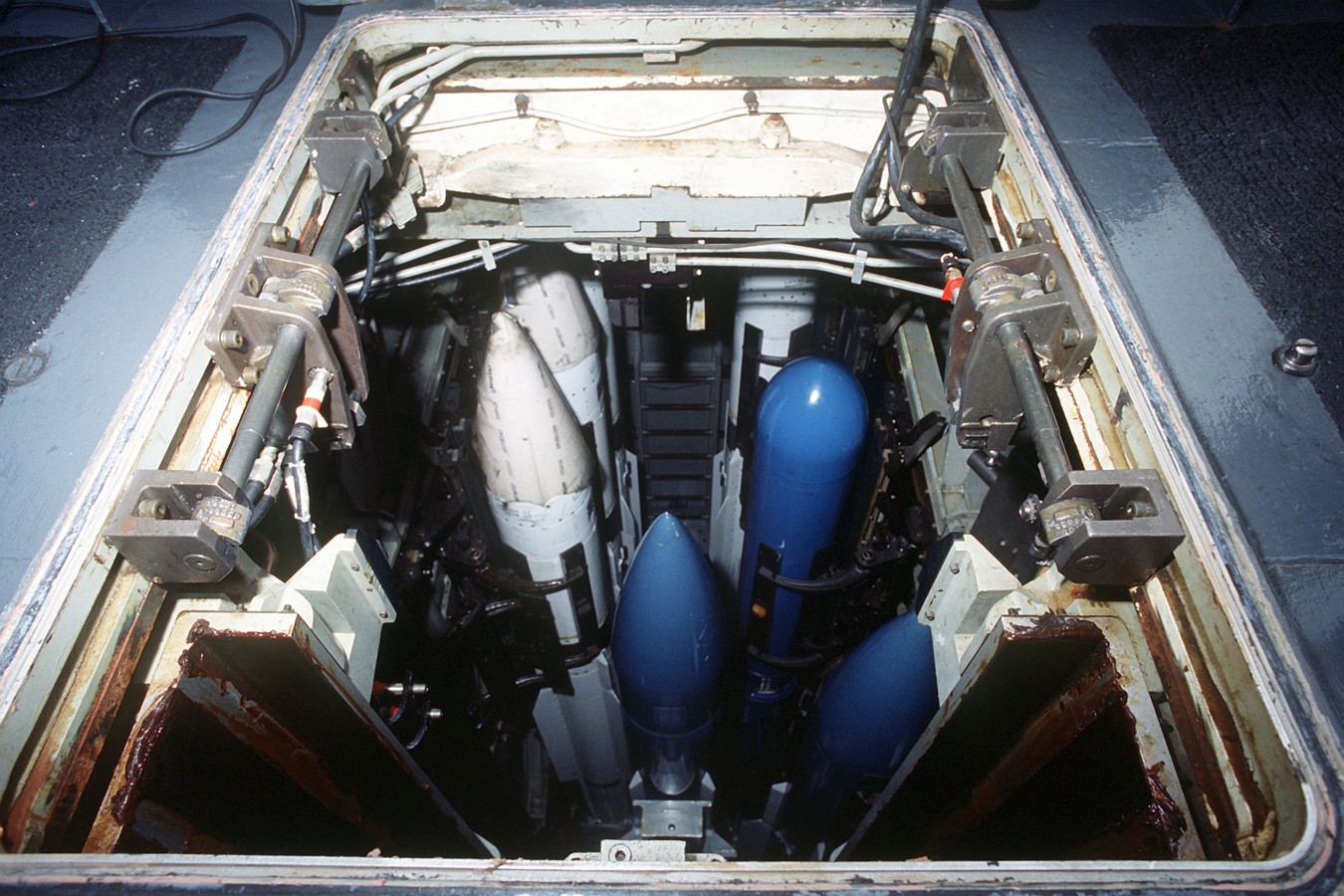

Question: Does it save space to have individual missile cells or to have less cells that be fed from under deck by a magazine?
Pretty sure it's better to have the cells, they really don't take up that much deck space and the big plus is rate of fire, as all missiles are available to fire at any time, no need to reload.
On the other hand:
Having the missiles in single-shot cells means that the vessel needs to return to port to rearm.
With a reloadable launcher then replenishing the magazine below decks might be something that could be accomplished at sea.
Chris Pook said:
On the other hand:
I think right there is a peacetime vs war time mind set. If you have the luxury of returning to port why plan to not be able to?
Hmm or a combo of the two types. The big issue I guess is ensuring no gases or flames get out of the launcher into the magazine space and also ensuring the magazine space is protected in case of fire or penetration damage. I wonder from a damage control perceptive if the individual cells are safer than a magazine style system?
That's why the Burke's have 90 to 96 cells each, so they can load up with missiles in case they get in a fight and can't reload for a while. It would take quite an effort to run them out of missiles. They could potentially carry up to 360 ESSM's. It's our mindset that is the problem with our 32 cells, thinking we're just there to have a presence and if anyone starts shooting call the Americans. If you look at the Spanish frigates they have 48 cells, that's 32 SM-2's plus 64 ESSM's, for a total of 96 missiles, to me that's the minimum. You don't need to worry about reloading in port if you've got 96 missiles ready to say hello.
Even if it starts as "fitted for but not with", limiting the design to 32 cells certainly appears to limit the design going into an unknown future.

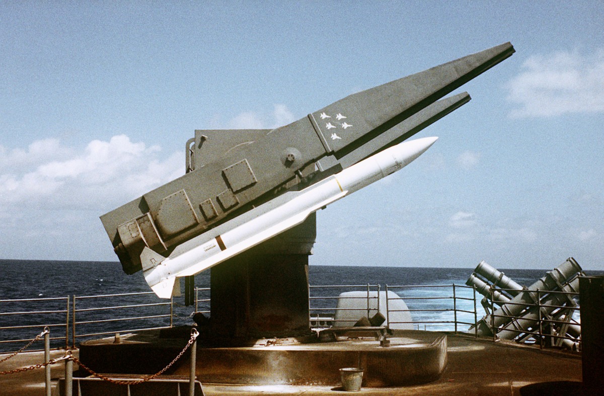

http://www.seaforces.org/wpnsys/SURFACE/Mk-26-missile-launcher.htm
Here's the launcher that preceded the Mk 41 VLS - the Mk 26.
I am going to guess that one of the major advantages of the vertical launch system was simplicity.  Fewer moving parts to fail.
Loading and Firing sequence video.
https://www.youtube.com/watch?v=uuRvHV6_1eQ
See Falklands war where one of these jammed at the exact wrong time.  There is also the limitation that you can't fire all your missiles in quick succession as overwhelming the ships defences is an important tactic.  Those would be overwhelmed relatively quickly.
Look at the moving bits in this video.
That's a LOT of stuff to keep working in order to launch missiles.
https://www.youtube.com/watch?v=sTz5kL6gzSI
VLS please!
