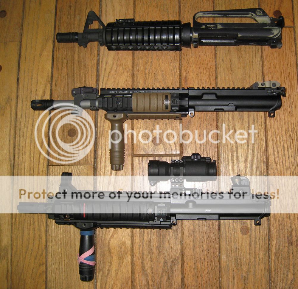

Hk 416 to M16FOW DI gas Short Barrel (11.5) Pictorial overview

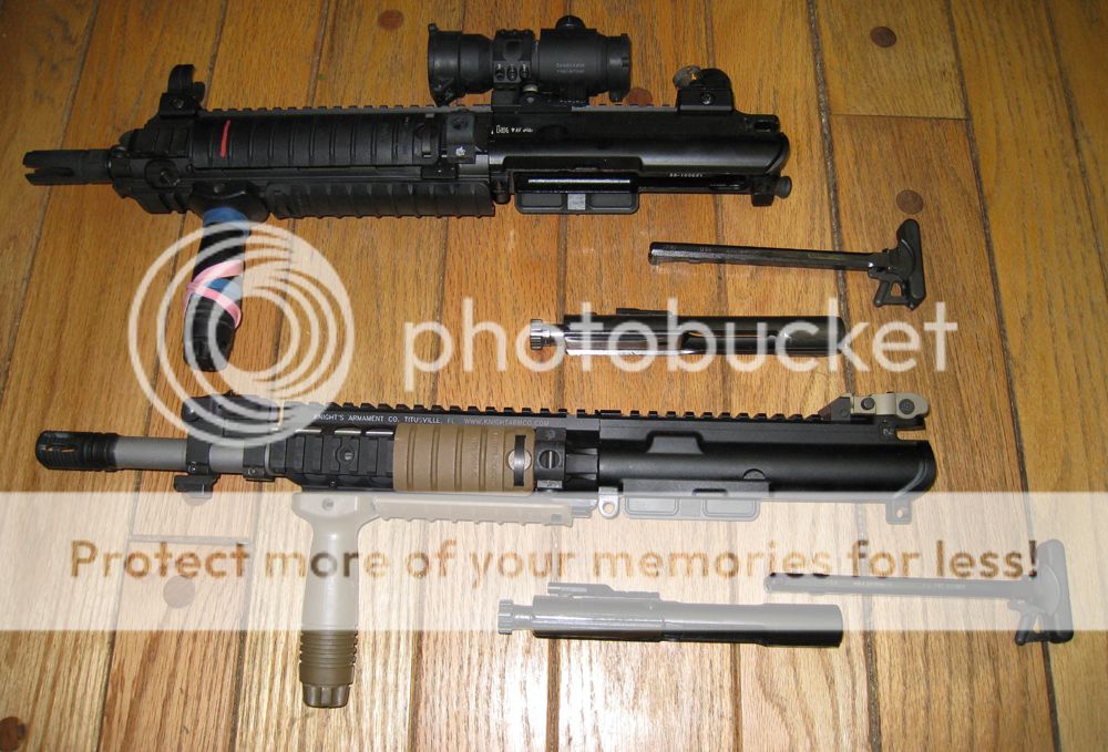

Both weapons fired for over 1100 rounds (800 AA40 Frangible, and 300 rds M855) ea.  No cleaning performed other than adding lube to the 11.5 DI gun three times.  I am not trying to lead a horse to water in this – just to offer up the observations on this issue.  The 10.3 was not fired in this aspect.
Weapons where shot semi-auto during a variety of drills, however no excessively rapid rates of fire where used, however the Hk416 was shot at a more rapid rate.  Two ammo related stoppages occurred with the 11.5 DI gun (one poor crimped round got stuck in the barrel, and one head of a round was managed on feeding – both with the AA40 Frangible Blackhills load), one stoppage was noted in the Hk416 with M855 - failure to feed, USGI mag)

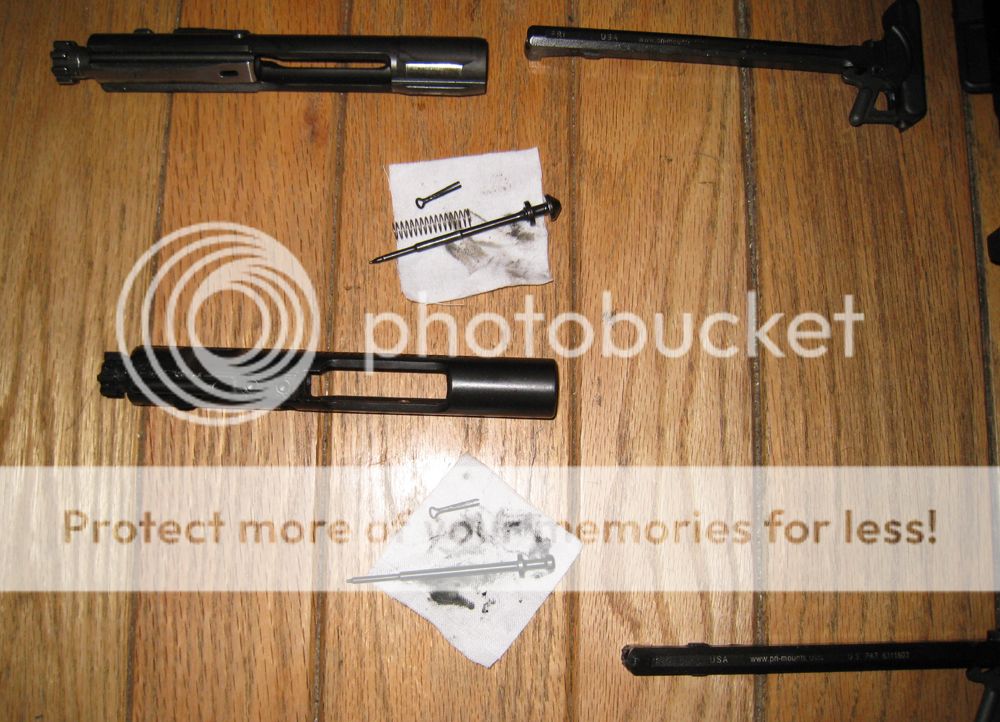

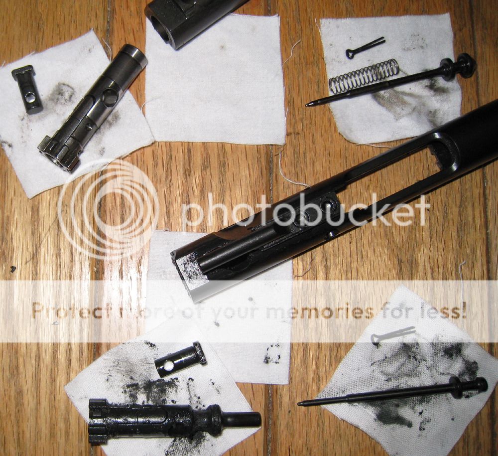

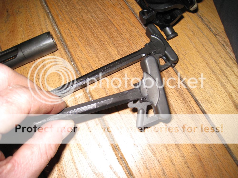

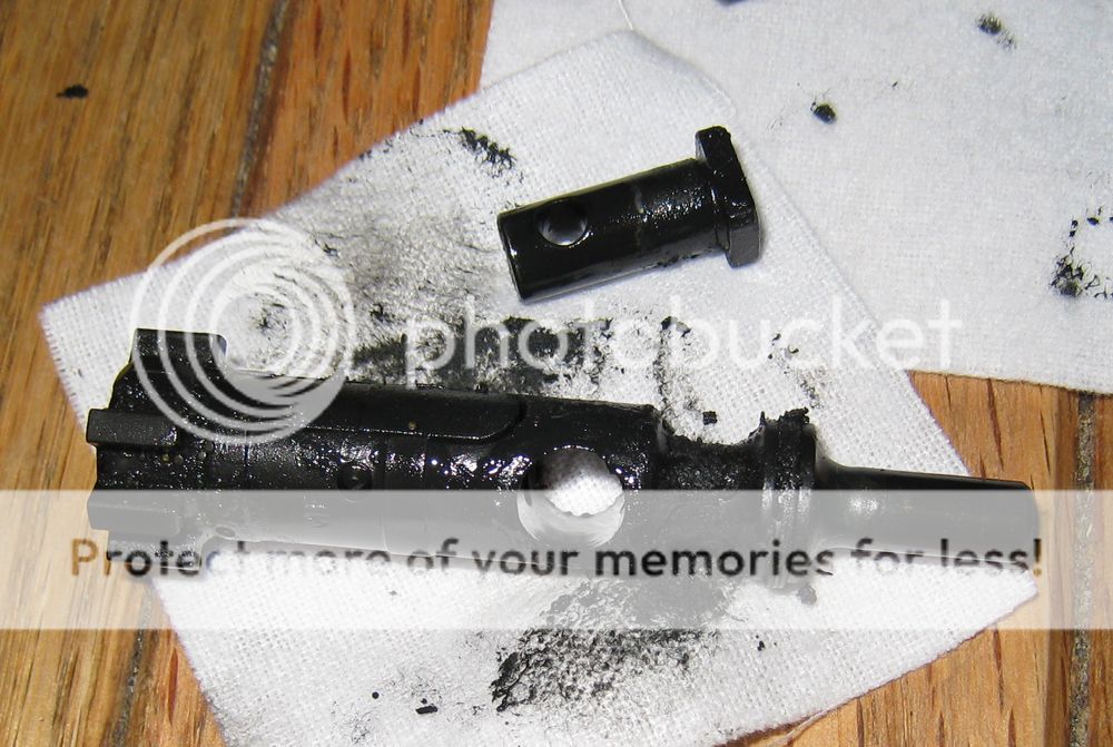

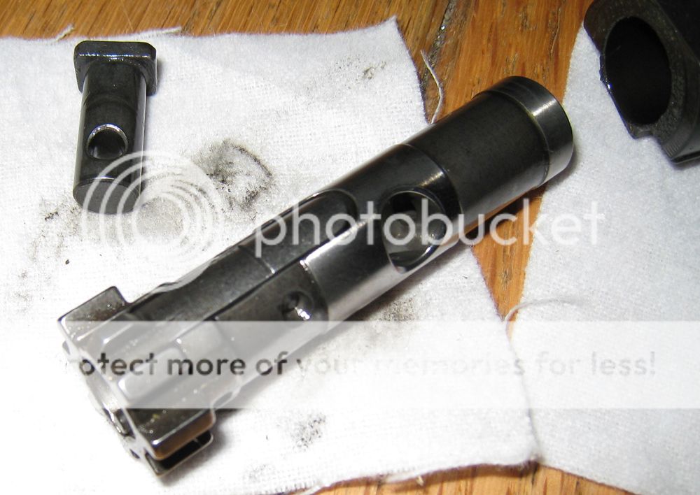

Weapons where stripped, and as to be expected the DI weapon immediately showed visible carbon build up
DI Bolt
Hk416 Bolt
Receiver bodies
DI
Hk416

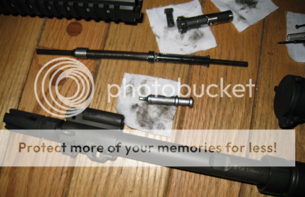

Hk416 gas system take out

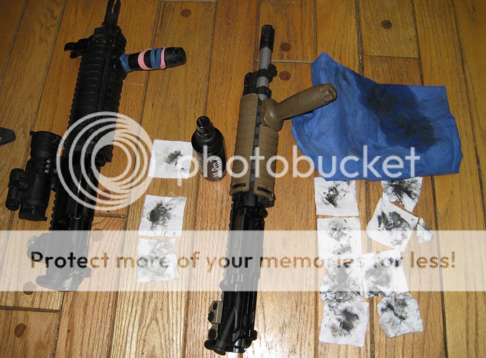

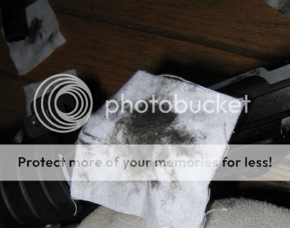

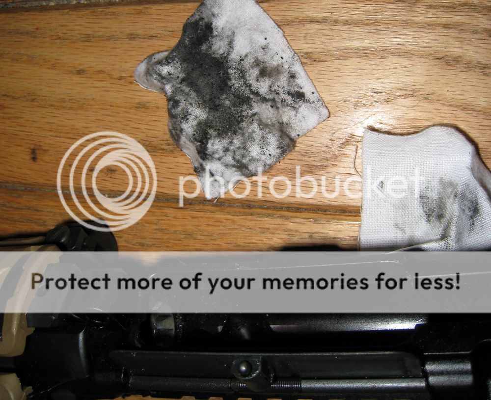

Quick wipe of chamber Hk416
Quick wipe of 11.5
Clean and lube requirements

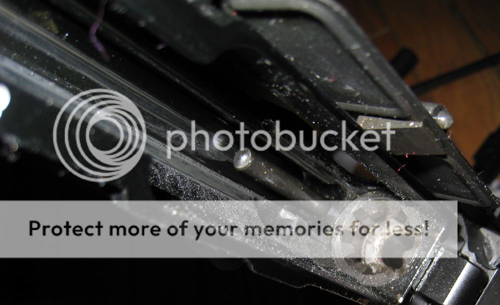

One issue to be noted – due to the round getting stuck and the bullet sticking in the chamber of the 11.5 gun, there was an abundance of ball powder accumulated – however it was absorbed into the carbon slurry and impossible to remove without a full cleaning so it was left in.
Cleaning the Hk416 took aprox 7 min – inc removing the handguard and replacing it.  Cleaning the 11.5 DI gun took aprox 15 min – inc relubrication.
I will not intially comment on the two - but will let this stew in peoples minds for a bit.
what i heard is HK416 has balance problem. Also, gas piston mechanism is less accurate than direct gas operation. That's why Bushmaster ACR uses  Free-floating barrel design.
I heard that it is better to remain silent and be thought an idiot, rather than opens ones mouth and prove it.
The Hk416 (and Hk417 7.62x51, and now the Hk418 as they split the 6.8x43 SPC guns off into their own subset rather than 6.8 416 guns as previously done) series guns are ALL freefloating barrel.
I will be back with a tutorial on the differences in the system in a bit.  I need to bang me head into a wall for a bit first.

The Hk gas system is remarkably cleaner - and due to wear the gas exchange is the bolt stays cooler - leading to a bolt life of triple + of a standard direct impingment system.
I'm not an engineer so my blather about the system is just from a knuckle dragging enduser -- I did stay at a Holiday Express a few nights ago, but I never took anything "mathy" in University.
  The bolt carrier has both a larger end piece to stop carrier tilt (due to the design of the pistons -- impact on them will not be center line like the gas impingment system is inside the bolt carrier/bolt), LWRC added a ring to their piston carriers, and while DI guns dont need them - any piston gun (POF, BM, Ares, etc don't and they all suck BTW) based on the M16 system requires the anti tilt expansion on the carrier.  The Hk is unique since it also has a firing pin safety so that the hammer must impact the bolt carrier to push the safety out of the way prior to hitting the firing pin (note well the Hk system REQUIRES the use of a full auto capable hammer).
While some crap and corruption is found in the chamber - due to gases in the casing and barrel upon extraction, it is visible cleaner and cooler than an impingment system.  The addition of a supressor, is much eaiser accomplished with a piston - however it does increase the gas vented into the atmosphere at the piston point (more Db) - and also due to increased back pressure - will result in more in the barrel and chamber.  NOTHING like a DI system however for fouling -- and the DI system will vent more gas out of the chamber into both the reciever and out the ejection post in some cases.

I had a chance to fire an "out-of-the-box" HK416 about two weeks ago.  Found it quite manageable and controllable in S/A and bursts.  We put about 1,000 rounds though it and I found it MUCH easier to clean up than any C7/M16 family weapon I've ever used.
Kev:  great quality photos, BTW (and a nice floor, too).
