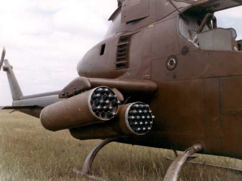

But there was a new kid on the block - the armed helicopter - and the US Army was looking for close support now that it had lost its air force to Dr Strangelove.
A volley of FFARs was as devastating as a heavy cannon with far less weight and recoil, and in the ground-attack role its marginal long-range accuracy was less important.....(FFARs) could be fitted with different warheads depending on the mission...a wide variety of specialized warheads were developed for antipersonnel, antitank, and target-marking use

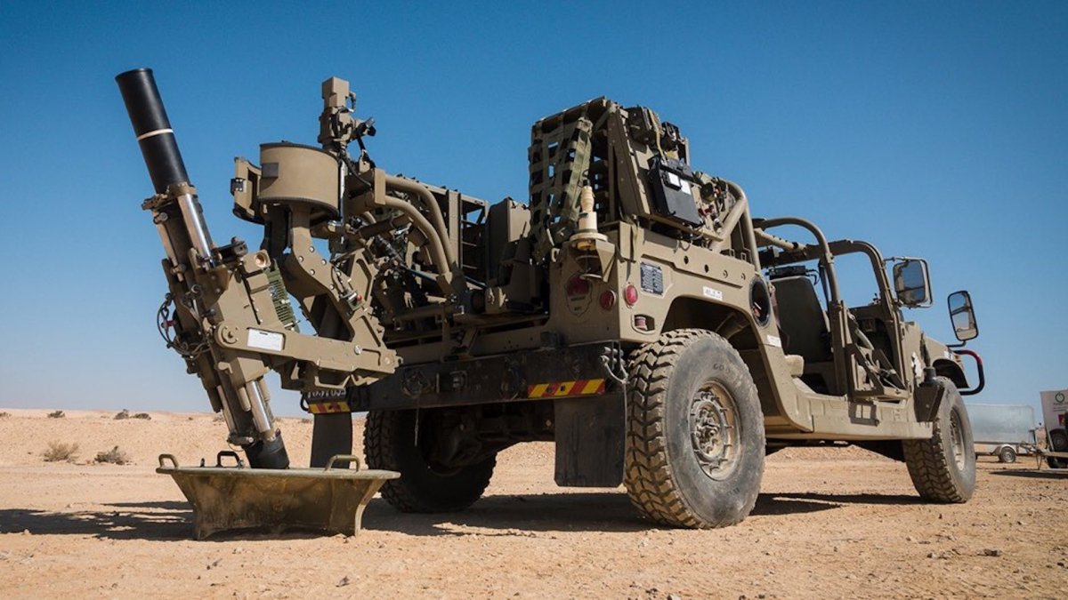

Is it harder to aim and maintain than a mortar? I don't know but the mortars mounted on trucks are no longer as simple to operate as a 60mm handheld.

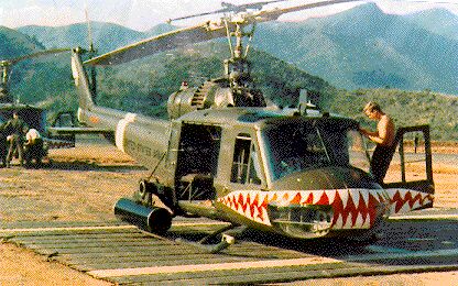

They became quite popular in Vietnam
The HE versions were equivalent in punch to a 105mm round. A single Huey could launch a stonk equivalent to a battery of 105s firing 8 rounds for effect. An Air Cavalry commander's hip pocket artillery, useful for the mortar role when the mortar didn't make sense.

So where would the 70mm rocket fit in the Canadian Arsenal? Light Infantry Weapons Coys, Light Cavalry Support Troops, AOPS UAVs and Helicopters, Griffons, Perhaps the MSHORADs as an alternative to the Hellfires? Artillery if the artillery is in the 10 km range band anymore?
You give the 70mm Rocket a lot more credit than it deserves.
I’ve seen Little Bird, Cobra and Apache combat runs with rockets and frankly they are pretty disappointing unless they ripple a ton at one target / or the target is a mass of folks (even then it’s fairly disappointing).
Sure it is a capability. But the Laser Guidance package makes the rockets a lot more expensive, and it’s only really a ~ 7lb warhead - with less than 4lbs NEC, only a tad more than the 60mm Mortar.
Where for example would a CRV7 equipped vehicle fit in a Canadian ORBAT?
I think I tried to answer this above.
With only around a 4km range you wouldn't want it in the direct support artillery regiment.
I agree entirely. But if its ballistic range is 10 km is that artillery? Personally I think artillery these days is out beyond the 30 km mark. Everything else is Direct Fire/Close Support, especially when aided by UAS observation.

Green Berets are testing a new highly mobile 120mm mortar system​
An Army Special Forces group is working on testing and fielding a brand new 120mm mortar system platform for U.S. special operations forces around the world, officials announced on Thursday.
The 3rd Special Forces Group (Airborne) has launched a new partnership with Elbit America, a subsidiary of Israel-based Elbit Systems, to “develop, test, and field” a new prototype mortar system platform known as “Sling” that comes mounted on the back of a vehicle, Sgt. 1st Class Zach VanDyke said in a statement.
Originally unveiled in January and designed to integrate with a standard Humvee, Elbit claims the system can deploy within 30-60 seconds and can fire off 16 mortar rounds per minute (with a sustained rate of 3-4 rounds per minute) at an effective firing range of up to 7 km, or 4.3 miles, with M933 High Explosive rounds.
This looks pretty cool...

I'm a firm believer in such things as a 120 mortar under armour in say a Stryker M1129 in the SBCT or an M1064/XM1287 for the ABCT with an extra 81mm as part of their kit to take on dismounted ops. Even better if its an enclosed turret like the AMOS.
US ICBT Infantry battalions still do it the old way. They have four 120mm (plus an 81mm each) mortars each with an HMMWV and trailer (The rifle companies only have 60mm mortars (no vehicles)). It gives you options that the Elbit system doesn't seem to. 120mm Mortar trailer with quick stow kit here.
Mortars are counter fire magnets. A light vehicle but with an armoured cab strikes me as essential. Preferably the mortar should be able to fire from under armour even if the crew is partially exposed while firing. Put the hydraulics into stabilizers that transfer the shock to the ground rather than the wheels. And each detachment should have an arms locker 81mm for dismounted ops.
The Wiesel did that in under 5 tons which isn't much more than what your average HMMWV would be with the Elbit kit attached
