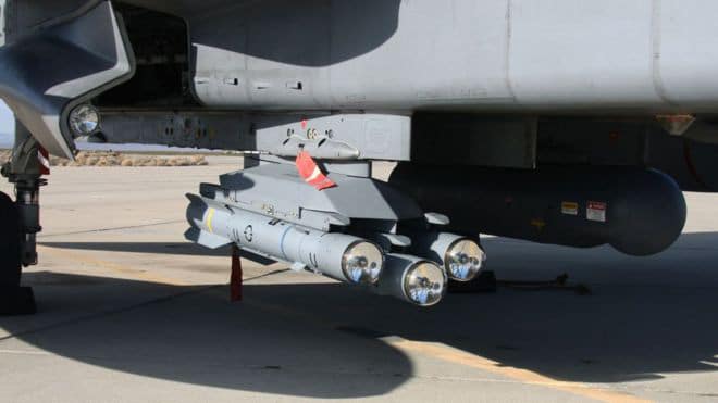

Brimstone 1, 2, 3, Sea Spear and Land Precision Fires
LPS is a match to MRLS/HIMARS launchers, SkySabre CAMM-ER launchers, Boxers, Ares and Supacat Coyotes.
Brimstone is also a match to Typhoons, Apaches, Lynxs, ships, boats and stationery platforms.

Rocket Artillery
Rocket Propelled Grenade - 40/85mm, M72 - 66mm, Hydra-70/APKWS - 70mm, Stinger - 70mm, Martlet - 76mm, Grad - 120mm, AIM-120 - 120mm, AIM-9 - 127mm, Javelin - 127mm, Starstreak - 130mm, NLAW -150mm, MRLS/GMRLS/GMRLS-ER - 227mm, Patriot PAC-3 - 300mm, SM-2 - 343mm, SM-6 1B - 530mm, ATACMS - 610mm, Minuteman - 1680mm, Trident - 2110mm, SpaceX Starship - 9000mm.
Brimstone (1/2/3)/SPEAR/SeaSPEAR/Land Precision Fires - 180mm
Ranges
  • Brimstone 1 - 12 km from a stationary helicopter and 20 km from a jet in flight
  • Brimstone 2 - 40 km from a stationary helicopter and 60 km from a jet in flight
  • SPEAR/SeaSPEAR - 7 km from a ship and 25 km from a helicopter
These are evolutions of the Brimstone, twice the mass and twice the length but the same diameter, warhead and sensors.
  • SPEAR 3 - 130 km
  • Land Precision Fires - >80 km
