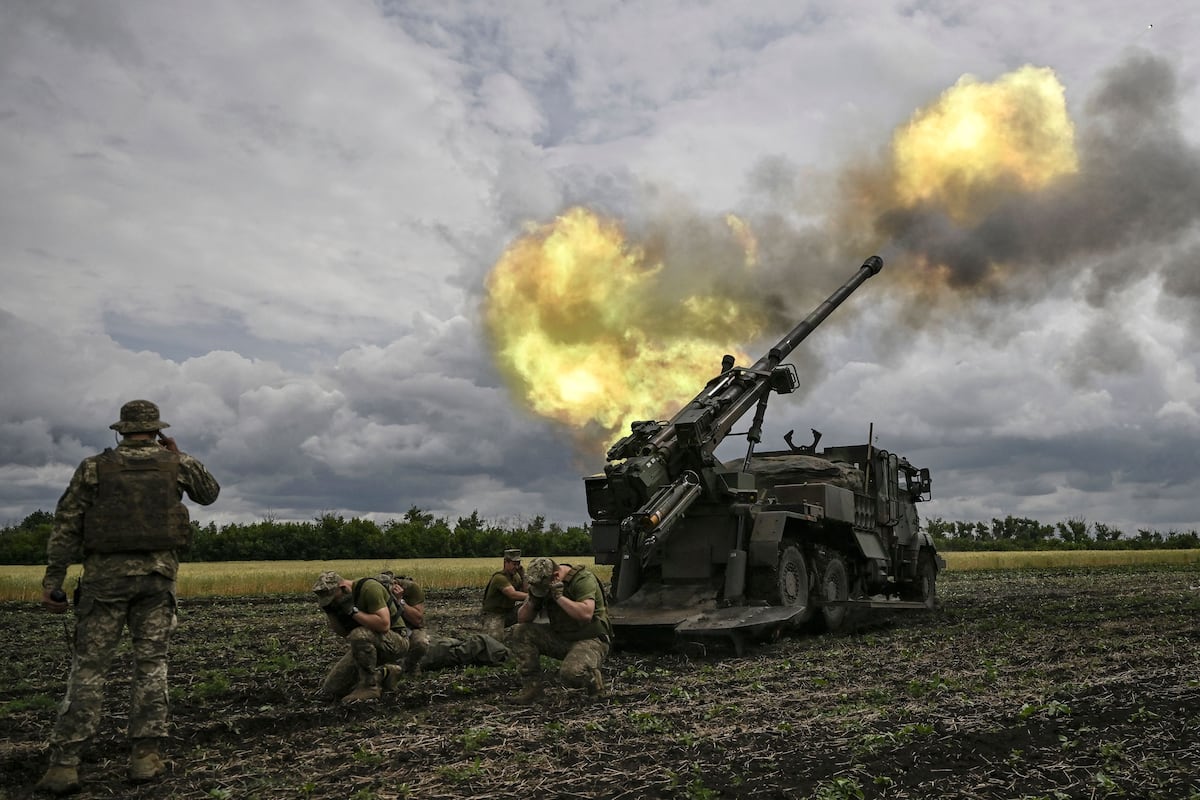

Artillery has been the greatest killer in the war in Ukraine, accounting for more than 70% of casualties
Ukraine has lost less than 10% of the truck-mounted Caesar howitzers it received from France and Denmark, with greater mobility resulting in a higher survival rate than for some other self-propelled or towed systems, according French manufacturer KNDS Nexter.
Losses for some other self-propelled or towed systems in Ukraine’s war with Russia amount to nearly 30%, the company said in a statement to Defense News, without providing specifics.
“Use of drones and loitering munitions has become a real threat 40 kilometers (25 miles) from the front, where the Caesar operates,” Nexter said in the statement. “Its light weight and ability to leave its position in less than a minute to avoid counter-battery fire are therefore major assets.”
Nexter has increased monthly Caesar production to six from two before the war, and the target “in the time to come” is 12 cannons per month, Lecornu said in a press conference following the visit. The target is to reach the new capacity within a year,
“For the time being, all Caesar production is earmarked for Ukraine and for replenishing stocks of the French Army, which may decide to make further divestments to Ukraine,”
Caesar II - Next Gen
France in December ordered 109 new-generation howitzers from Nexter for about €350 million, with first delivery expected in 2026. The updated cannon will have an armored cabin to protect against mines and small-caliber arms, based on the feedback from French deployments in Afghanistan and Africa’s Sahel region.
The Caesar MkII will get a new 460 HP engine more than double as powerful as the previous 215 HP one, a new six-wheel chassis from military-vehicle maker Arquus, and updated fire control software. The howitzer will keep its 155mm cannon, with a range of more than 40 kilometers, and will remain air-transportable, according to France’s armaments directorate.
