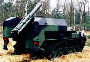

Or some of those gunners could be tasked to something like this
Wiesel 2 lePzMrs
1x Driver, 1x Loader, 1x Commander
Perhaps the system could be mounted in a TAPV or a LAV.
