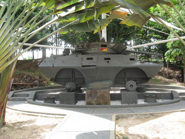

Funny I was on a Malaysian defense blog and they were lamenting that the Ferret is still one of thier most heavily armoured wheeled vehicles.
You know a slightly taller version to allow better seating for the crew might just work.
I don't think a Ferret would cut it any more. The two man crew would be pretty hard pressed (especially if there was a need to dismount for any reason), there isn't the space for modern electronic gear (except the driver's iPhone  ;)) and the protection against modern threats like automatic cannon, IED's and NBCW attack is nonexistent.
Starting from a fresh sheet of paper would probably come up with something like the PM proposal, and indeed it seems to be such a "doable" project that a smaller defense contractor *could* build a prototype fairly quickly and cheaply. The only two changes that I might suggest would be to "build up" the back of the vehicle to hold either more stores or perhaps two more troops (this space cold also be used to help evacuate casualties), and dispense with the "wet" armour and replace it with cheaper thermal "blankets" to reduce the IR signature.
Ferret armour is pretty good considering. This Commando took a RPG 7 hit that both pentrated the armour and cracked it. The crew died.
