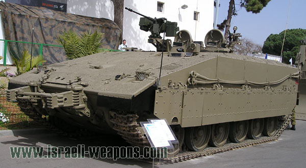

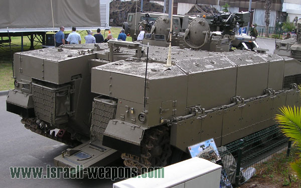

a_majoor said:
Tha Achzarit is the premier "HAPC" design
Not any more.  Google Namera
Re Namera....
I see the same "problem" as with the Merkevah (?sp)
rear door appears to be relatively narrow... though I am happy to see that it is a ramp and not a door.... Ohh the times I would come out of the narrow door of a grizzly/cougar and get tangled up OR crash into someone ahead of me who got tangled up..... Grr..... Thank god the Bison & LAV went back to the M113 ramp system.
