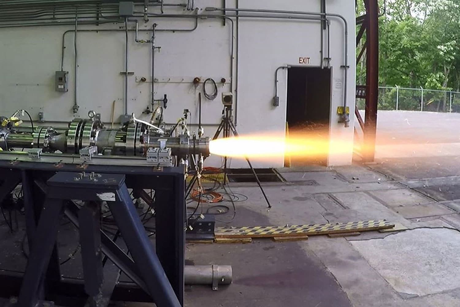

Norway's NAMMO has been touting their Ramjet developments since 2015 at least (150 successful test burns as of 2019). I wonder if any of these systems are making it into the field.
When applied to 155mm x L52 artillery NAMMO claims ranges of up to 150 km. That means that Caesars, PzH2000s, AS90 Bravehearts, and the Polish Krabs are all potential launchers.
Further down the road it is reasonable to envisage Ramjet versions of every missile fielded with either 5 times the range from the same size missile or the same range from a missile 20% of the size (allowing them to be launched from smaller platforms or carried in larger numbers)
Progress - 155mm Ramjet projectiles tested in Norway in April of this year.

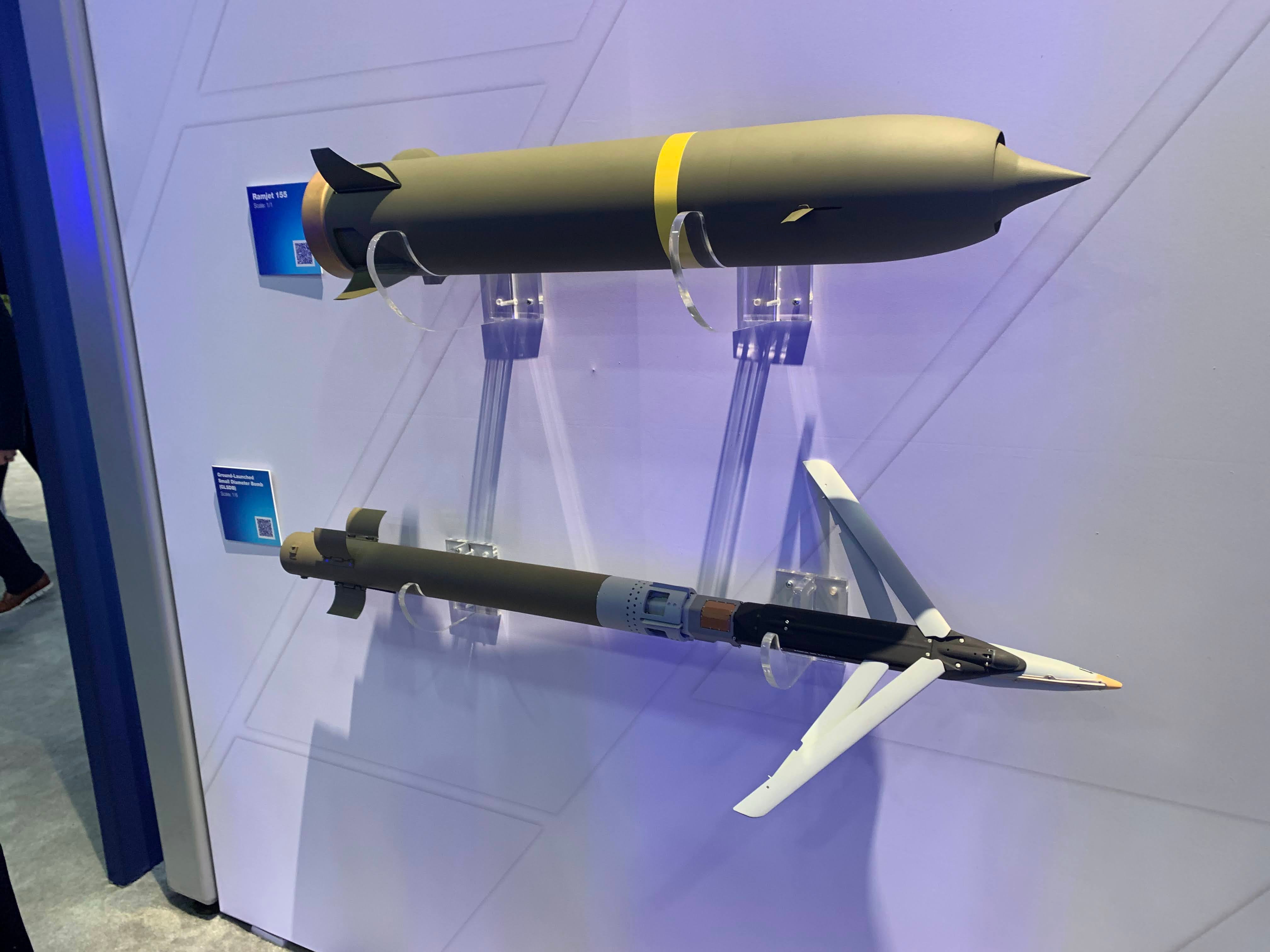

The U.S. company Boeing and Norwegian Nammo tested a new 155 mm Ramjet projectile for NATO standard artillery.
What we know​
The Ramjet is being developed as part of the modernization of existing weapons for the U.S. Army. Despite the fact that the tests became known only now, the tests took place at the end of April 2022 in Norway. The military checked the operation of the jet engine, which "showed flight stability.
Work on the new artillery projectile began in 2019 as part of the XM1155 Extended Range Artillery Projectile program. The project was funded by the U.S. Army. The Ramjet is equipped with an air-jet engine, thanks to which it requires less fuel and can accelerate during flight. The maximum launch range is 70 km.
The Ramjet is designed for the advanced ERCA (Extended Range Cannon Artillery) project, which was previously called the M109A8. However, the M777 and M109A7 Paladin howitzers will also be able to use the new projectile. With its help they will be able to destroy enemy tanks on the move.
