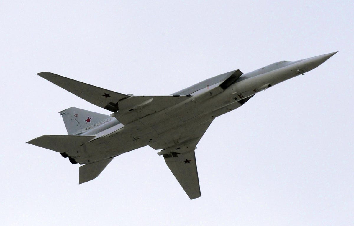

Install 'Zero-Zero' seats, like this Russian Backfire Bomber didn't have last week?
