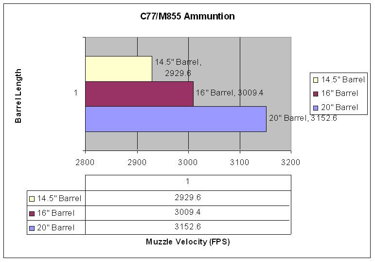

As I mentioned above you will need to buy 62gr SS109 projectiles and load them to a velocity pertaining to the barrel length you have if you want an exact C77 clone load.
This was some chrono'd ammo I did while in the CF with C77 ball
However personally would not sweat getting an exact match, any loading that you can do that will give you more experience with the weapon system will be benificial -- and the enemy never shows up on a KD range, so specific range holdovers are not so crucial, as unless you have access to a LRF overseas, its going to be JD and adjusting your fall of shot as applicable.
