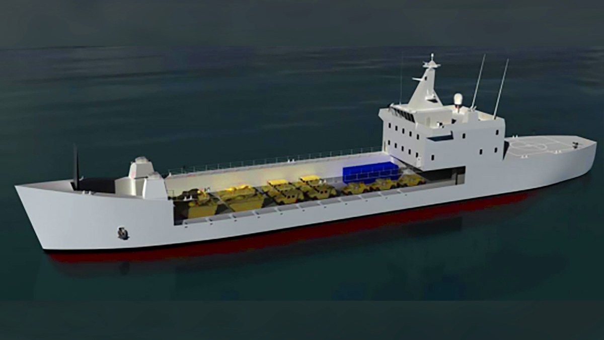

Damen 120 requires a crew of 18, for domestic ops and Caribbean, that should suffice.
Name your poison Gents.
PS.
Army vs Navy
US Navy wants 70 sailors to transport 50 marines.
US Army wants 13-23 mariners to transport 175 soldiers.
Digression on the Landing Ships as neither of those have particular relevance to helo/uas ops.
