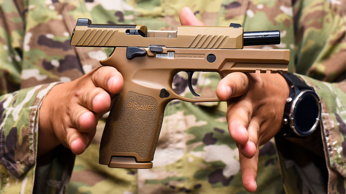

Air Force Grounds M18 Pistols After Fatal Discharge at F.E. Warren Air Force Base
The U.S. Air Force’s Global Strike Command has indefinitely halted the use of the M18 pistol after a tragic incident at F.E. Warren Air Force Base on July 20, 2025, left a Security Forces non-commissioned officer dead. The standard-issue sidearm, a military variant of the SIG Sauer P320, allegedly discharged while holstered, striking the Airman in the chest without any physical manipulation of the trigger.
In response, Global Strike Command ordered all M18s removed from operational and training use. Personnel assigned to nuclear security duties have been temporarily issued M4 rifles in place of sidearms, and a command-wide inspection of every M18 pistol is now underway. The investigation is being led by Air Force Special Investigations and safety review boards.
Incident Details: Holstered Pistol, No Trigger Pull
Eyewitness accounts and unofficial internal reports describe a chilling scenario: during a routine task, the holstered M18—chambered and secured—was set down on a table. Without any trigger input, it discharged. The round struck the Airman in the chest, resulting in an immediate fatality. Though the Air Force has not released full investigative findings, internal memos indicate that an “uncommanded discharge” is the focus of inquiry.
