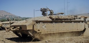

I admit that that is a very important consideration. I've looked at the Merkava (a front engine MBT) and its barrel depression is anywhere from -7 to -8.3 degrees while most NATO tanks are a degree or two better than that and all Russian tanks worse. But the tank has always been a trade-off product (protection vs firepower vs mobility). This too is a tradeoff. Glacis and turret design can be adjusted (especially if one is designing from scratch to build a common tank/IFV/SP hull) to maximize barrel depression while providing for safer crew location. Just spitballing here but how about a tank with the engine in front, an autoloader turret in the middle that doesn't penetrate the hull deeply and an armoured crew compartment in the rear with easy egress and just enough access to the turret to help fix stoppages. There are more than enough redundant video feeds available so that a front position for a driver and a top position for a crew commander are no longer essential.
