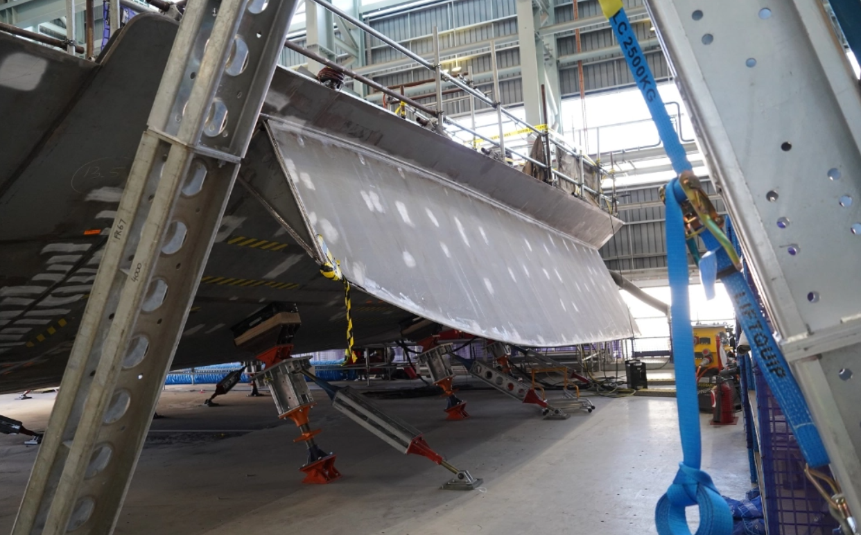

If you look at other navaltoday articles like this one back in 2023, they copy and paste basically the same text regarding 24 Mark 41 VLS and Sea Ceptor, so I think its just poorly researched regurgitation of the base UK model.Some news on the Australian Hunter class construction progress:
Construction advances on Australia’s first Hunter-class frigate
The Hunter-class Frigate Program has hit a milestone after the first two machinery units for the first ship were consolidated under the construction phase of the program.www.navaltoday.com
I found it interesting that these also appear to be limited to 24 MK41 cells. It has been widely reported in "other" forums that the Hunters would have 32. Also interesting the reference to a VLS for Sea Ceptor. That is something I have not seen associated with the Hunters before.
