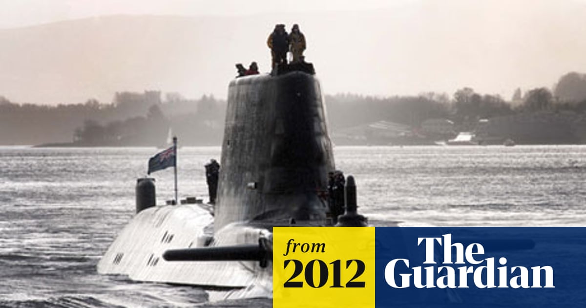

The Royal Navy's new multibillion pound hunter-killer submarine, HMS Astute, has been beset by design and construction flaws that have raised doubts about its performance and potential safety.
The Guardian can reveal that Astute, the first of seven new submarines costing £9.75bn, has been unable to reach its intended top speed.
At the moment, the boat, heralded as the most sophisticated submarine ever built for the navy, cannot sprint to emergencies or away from an attack – an essential requirement for a hunter-killer boat.
It would also be incapable of keeping pace with the Royal Navy's new aircraft carriers, which will be able to travel at more than 30 knots and need the submarines to protect them. One source told the Guardian the boat had a "V8 engine with a Morris Minor gearbox".

Slow, leaky, rusty: Britain's £10bn submarine beset by design flaws
Exclusive: the 'most sophisticated submarine ever built' has 'a V8 engine with a Morris Minor gear box'www.theguardian.com
From the 2012 article
Since that article the RN has commissioned another four hulls in the intervening 12 years. One gearbox every three years. Was this the gearbox that the Type 26 was planning on using as a template?
6 of the 7 Astutes are complete with one still building.
