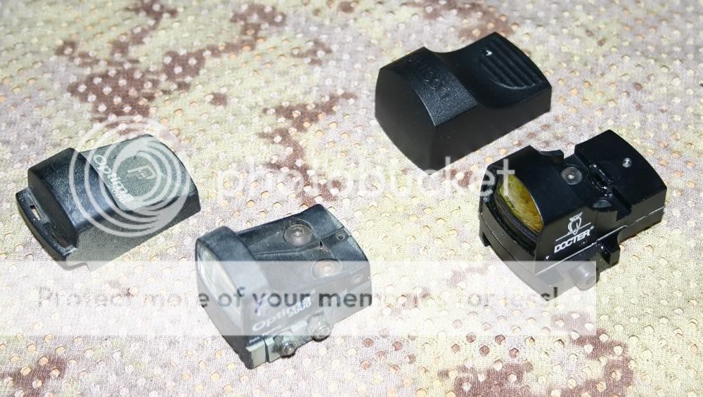

and the Dr that center mounts. (from me)

I found the pic but it was on my ARF gallery -- and thus I cannot host it inline -- just a link to it.
http://photos.ar15.com/ImageGallery/Attachments/DownloadAttach.asp?iImageUnq=17310
