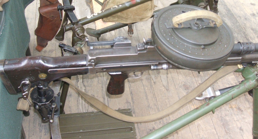

Other Bren kit:
100 Rd Drum
Bren SF
Bren Anti-Aircraft
Note loader and total of 12x 30 rd mags for 360.
