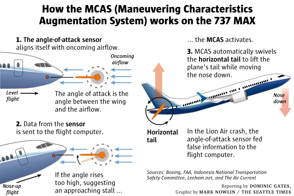

Start of detailed and lengthy Seattle Times story that is potentially devastating:
Flawed analysis, failed oversight: How Boeing and FAA certified the suspect 737 MAX flight control system
As Boeing hustled in 2015 to catch up to Airbus and certify its new 737 MAX, Federal Aviation Administration (FAA) managers pushed the agency’s safety engineers to delegate safety assessments to Boeing itself, and to speedily approve the resulting analysis.
But the original safety analysis that Boeing delivered to the FAA for a new flight control system on the MAX — a report used to certify the plane as safe to fly — had several crucial flaws.
That flight control system, called MCAS (Maneuvering Characteristics Augmentation System), is now under scrutiny after two crashes of the jet in less than five months resulted in Wednesday’s FAA order to ground the plane.
Current and former engineers directly involved with the evaluations or familiar with the document shared details of Boeing’s “System Safety Analysis” of MCAS, which The Seattle Times confirmed...
https://www.seattletimes.com/business/boeing-aerospace/failed-certification-faa-missed-safety-issues-in-the-737-max-system-implicated-in-the-lion-air-crash/

Plus from AvWeek:
Flight Recorder Data Links Ethiopian, Lion Air MAX 8 Crashes
Investigators believe faulty data from an AOA vane triggered MCAS during JT610’s flight, even though the aircraft’s nose was not too high. The flight crew responded with opposite nose-up commands, but MCAS is programmed to continue trimming nose-down based on the data it receives. With the AOA vane feeding erroneous data, MCAS kept attempting to push the 737 MAX 8’s nose down, and the pilots responded with nose-up commands. This back-and-forth continued for several minutes, causing the aircraft to lose and gain altitude, before it dove into the Java Sea, killing all 189 onboard.
A profile of ET302’s 6-min. flight based on satellite data provided to investigators by space-based ADS-B provider Aireon suggested similar flight control problems before it, too, dove to the ground. The [Ethiopian] transport minister’s statement solidifies the theory that the accidents are related...
Boeing is testing modifications to the MAX flight control system that will change how MCAS operates. FAA plans to mandate the upgrade as soon as it is validated.
Investigators’ ability to link MCAS to both accident sequences would further implicate the controversial system, which most pilots did not know existed prior to the JT610 accident and subsequent probe. But it also may expedite lifting the global MAX operations bans.
Boeing has been working on the flight control modifications for months, based on the early JT610 findings. If regulators determine the fixes and related training go far enough to reduce MCAS’s risk and improve pilots' understanding, the ban could be lifted without awaiting further progress in the ET302 probe.
https://aviationweek.com/commercial-aviation/flight-recorder-data-links-ethiopian-lion-air-max-8-crashes

C130J has 2 AoA vanes, if they disagree then the stick pusher is disabled and you get an associated warning. Sounds like something like this would work.
MAXs do have two vanes, but MCAS was taking a feed only from one, Kev.  The article surmises that a s/w fix will include polling both AOA vanes.  Also, the single-cycle pusher would go a long way to easing the pilots' ability to respond to and control the situation.
