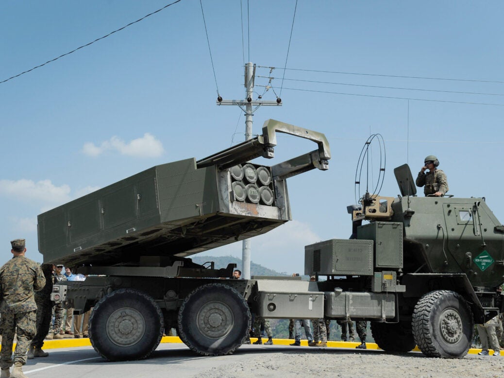

The worsening geostrategic environment is motivating Taiwan’s decision to purchase additional M142 High Mobility Artillery Rockets Systems (HIMARS)
In its proposed defence budget for 2023, Taiwan has allocated funding for the acquisition of 29 HIMARS, as well as 84 ATACMS surface-to-surface missiles (SSM) and 864 precision guided rockets
Having initially planned to purchase 11 HIMARS launchers and 64 ATACMS missiles, Taiwan was forced to update its planned defence expenditures after original plans to purchase 40 M109A6 Paladin self-propelled howitzers were cancelled in May due to “inadequate production capabilities”
Analysts highlight the extremely high attrition rate of both advanced and legacy platforms in a high intensity conflict. “The previous efforts to enhance deterrence by acquiring small numbers of advanced platforms and systems have come under increased scrutiny over the past several months,” says Sauer.
“Concerns mount that such an approach would provide ‘priority targets’ for any hostile. Once defeated, these would cripple the military’s capacity to react and respond.”
A paradigm shift has occurred in the Taiwanese procurement priorities, with funding being diverted from large-scale procurement programs to support the development and purchase of more affordable force-multiplier technology. These include tactical uncrewed aerial systems, anti-tank guided missiles and man-portable air defence systems.
