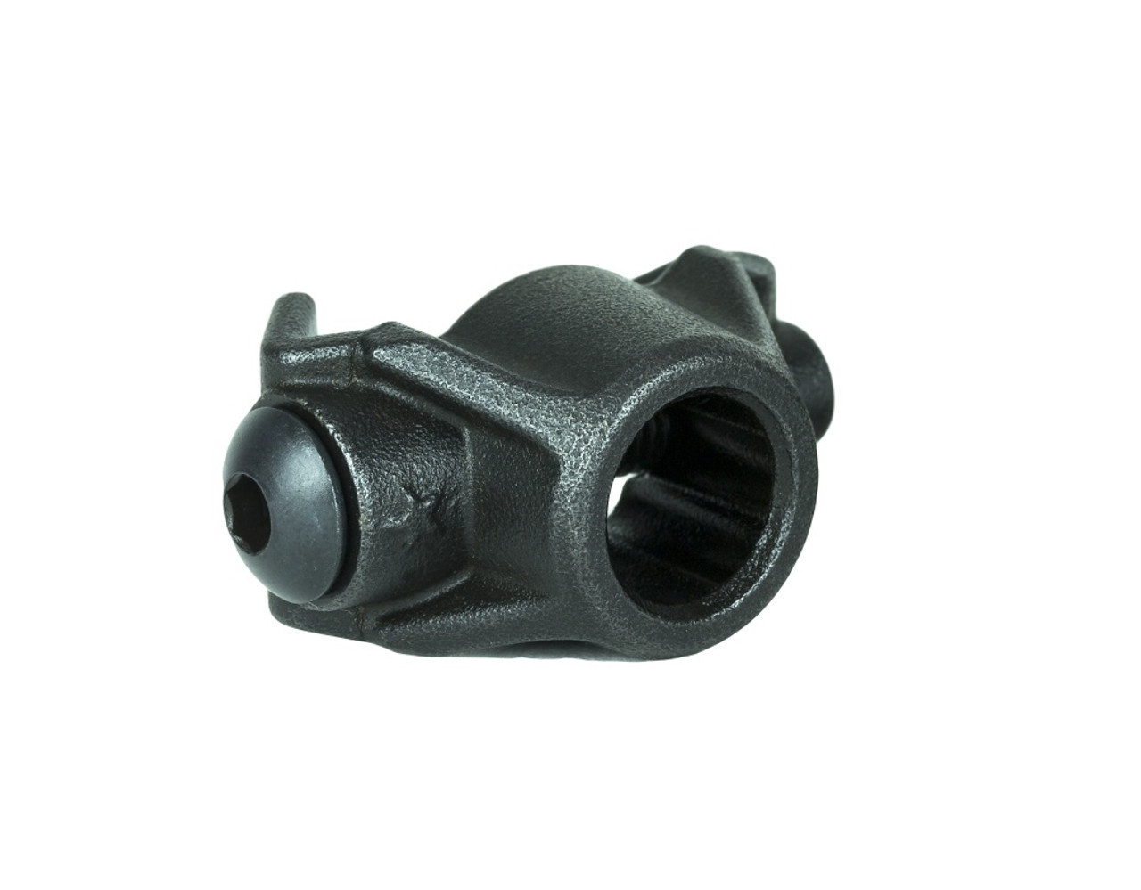

Over anything else for upgrading an issue C7 quickly after drawing it without major disassembly I would add a good modern sling and mounts.
Something like this for the buffer tube.
Something like this for the tri mount
