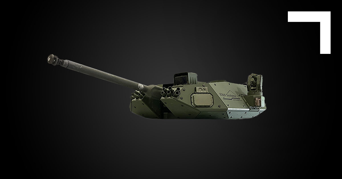

meanwhile at GD, trying to drum up that medium CAV force, Though I think many of these turrets and options we could throw on the M10 hull for a tracked medium force.
