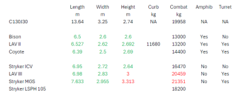

Agreed. The LAV III, with its LAV-25 turret is too heavy and too high. No question.
But the Stryker ICV M1126 weighs in at 16.47 tonnes, and is 104" tall (2.64 m), 107" wide (2.72 m) and 6.95 m long.
The height can be reduced by folding the RWS and also by removing the air from the run flats.
Also the width of the vehicle is not the width of the wheels. The vehicle overhangs the wheels.
The Stryker family of vehicles, with the exception of the double V-hull, remains C-130 transportable today. The capability of being transported by C-130 enables the Stryker brigade to conduct early entry operations in support of a host nation or as a follow-on force to expand the lodgment of a forcible entry operation
Most readers are aware of the constant trade off when developing armored vehicles; the balancing act of mobile protective firepower is — and always will be — a source of contention and debate. It is important to note that the Stryker family was designed to be C-130 transportable and capable of landing on an assault landing strip.2 The Stryker was specifically designed with a myriad of add-on packages of armor to increase protection while maintaining C-130 assault strip capability.
The assault strip capability was placed on the Stryker since its inception for the purpose of being air movable anywhere in the world. A majority of landing strips in austere environments are only C-130 capable. The Stryker family of vehicles, with the exception of the double V-hull, remains C-130 transportable today. The capability of being transported by C-130 enables the Stryker brigade to conduct early entry operations in support of a host nation or as a follow-on force to expand the lodgment of a forcible entry operation. Not only does the U.S. Air Force (USAF) have more C-130s than C-17s and C-5s, our allies around the globe also own significant numbers of C-130 aircraft.
Even the MGS M1128 was air portable in the C130
The MGS was originally developed for the Canadian Army, which did not have a requirement for transporting the vehicle via C-130. The U.S. Army did have this requirement, and so a design change was required to lower the MGS's height so that the vehicle could fit inside the aircraft. The turret was lowered within the hull. This change caused problems of its own. The reduced distance between the muzzle brake and the hull caused blast overpressures to develop. A solution was found where the "pepper pot" could be covered by a sheet of metal.
The M1128 weighed in at 18,770 kg combat loaded. Maximum payload for the C130J is given as 44,000 lbs or 19,958 kg and the C130J30 is given as 46,700 lbs or 21,183 kg.
The key elements on the LAV III are its weight and its height and the height is entirely due to its turret.
The weight of the LAV III Up and the LAV 6, as well as the Double V hull variants and the Dragoon are a result of ignoring the original Stryker design constraints.
All that said I agree with you on the LAV II as being the optimal design solution. It is the 80% solution as far as I am concerned leaving a useful margin when loaded in the Herc.
