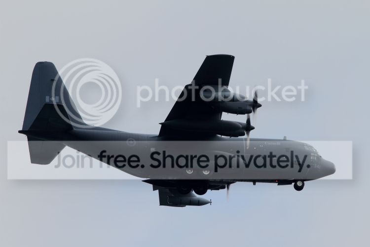

CC-130H (T) with fuel hose deployed in a refuelling pattern with CF-18's
Closeup of tanker w/ fuel hose housing on the outside of the wing.

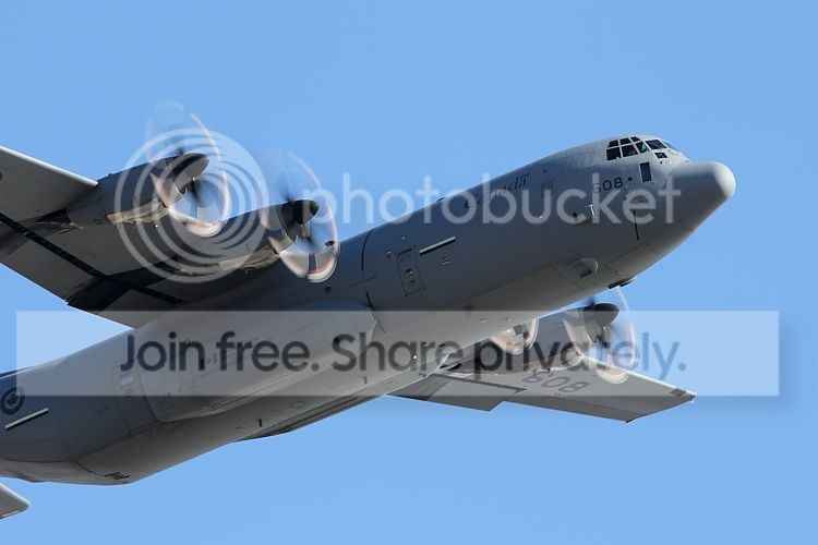

New CC-130J Hercules - no AAR refueling capability.

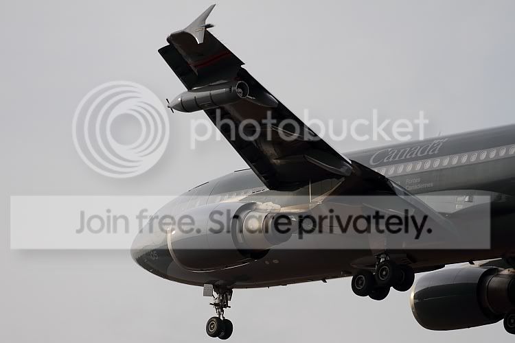

A CC-150 Polaris tanker - the RCAF's other refueling platform.
