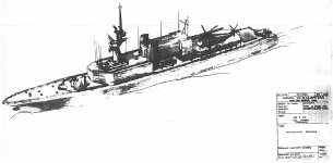

What if the RCN had a plan for HMCS Bonaventure?
As far as I can tell, when the Banshee was retired in 1962 there were never any serious attempts to find a replacement, notwithstanding the abortive looks at the A-4.. As well, there seems to have been a disconnect with the building of the St Laurent class and the reality of the evolving threat. Other classes of the time were starting to incorporate air defense, and area air defense was in full development. Self defense examples are the Charles F. Adams class with Tartar, and the Leander class with the Seacat. Area air defense vessels included the Belknap class cruiser in the USN and the County class destroyer in the RN. Canada did not acquire a point defense capability until the Iroquois class, and an area defense capability until TRUMP, in the early '90s.
Why is this significant. Around the time of Bonnie's retiremnt in 1970, Soviet Naval Aviation were starting to acquire long range maritime strike, in particular the TU-22M Backfire, carrying the 320nm range Kh-22 Storm. Operating an ASW group centered around Bonnie in that threat environment would have been suicidal. Can the argument be made that the only reason that a Canadian ASW Task Group of that era have operated in wartime conditions is because it would have been "insignificant" enough that the Backfires' attention would have been elsewhere?
Air defence requires layers: the outer layer is a fighter CAP, the middle layer area air defence, and the inner layer the point defnce systems. In the case of the Backfire, it is desirable to attrit some of them before they launch. Hence the need for the fighter.
One option would have been what was considered in some measure. Actually obtain the A-4G Skyhawk which was developed for the RAN for fleet air defence operating from HMAS Melbourne. Additionally, the Improved basic point defense missile system (IBPDMS) could have been installed in the early 70's. Finally, could the Iroquois class have been given an area air defence capability from the start. Would these measures have kept Bonnie relavant as the center of an ASW TG?
Would such a plan have possibly led to consideration of acquiring 1-2 Invincible class through deck cruisers (aircraft carriers) and Sea Harriers to operate off them?
This thought bubble is not merely "what might have been." It also informs why the decision to dispose of Bonnie "as she was" in reality was driven as much by operational need, as it was by politics, unification, and down-sizing. Which in turn speaks to how we reconfigured the Sea King in the 70's.
And all this also speaks to how we went from 20 "cadillac" derivatives of the St Laurent class (incl the St Laurents, Restigouches, Mackenzies, and Annapolis') to 8 effective ones for ASW (the DDHs) that still couldn't defend themselves from air attack...
