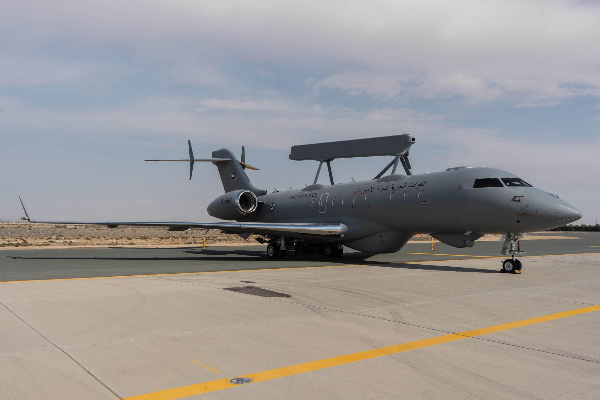

And it's on a Global 6000.
For the last time, that is not an MPA. It even specifically says it’s an early warning (AKA AEW&C…maybe without the C) aircraft.
So closer to an E-2 Hawkeye than a P-3 or P-8. Even the letters in the US system are different, denoting different mission sets.
I know that.
I was replying to the post about Saab not having a market for their mission aircraft and Globaleye was mentioned as one of them.
