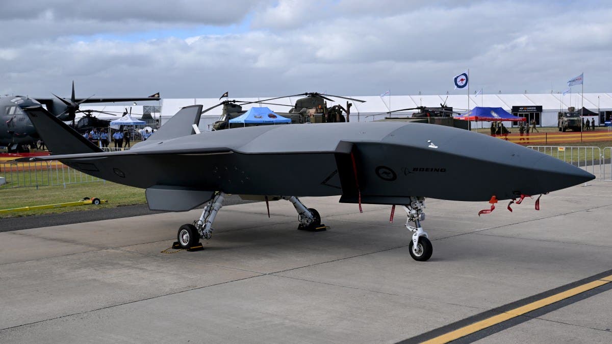

Why would you waste the effort to develop runway dependent solutions that increase vulnerability, decrease deployability, decrease range and increase cost?
Is the Air Force that wedded to its runways?
