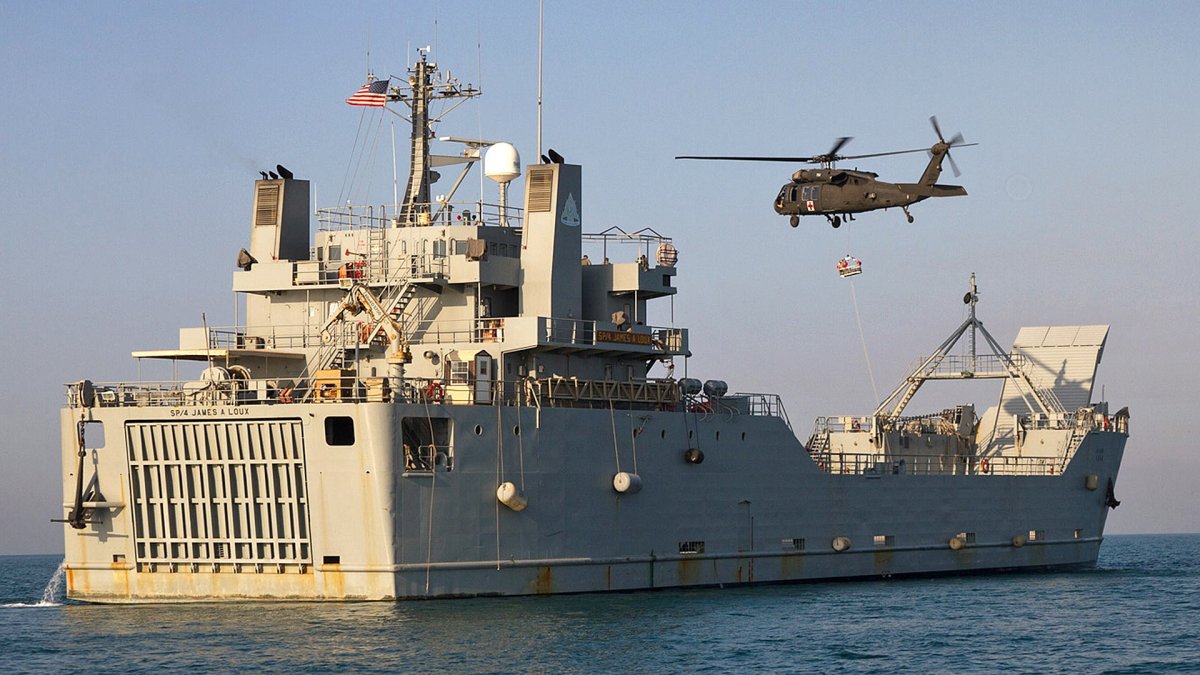

Really a very interesting capability. Back in the late 70's I was part of a staff tour visiting Fort Eustis and their Logistic branch's railroad and terminal battalion organizations. The ship to shore organizations with a variety of ships and boats were an eye opener as were all the hulls around the corner which were part of the Navy's reserve fleet.
There is a solution to this, hire the US Army to do it.
I believe the Army uses Warrant Officers to command those Landing Ships. Not Commissioned Officers.
I also believe that there is some crossover in design specs between the Light Amphibious Warship and the Large Unmanned Surface Vessel.
