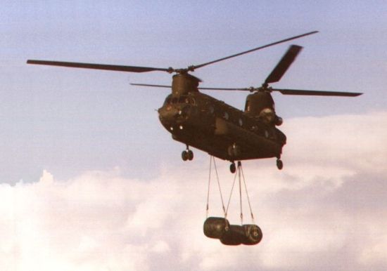

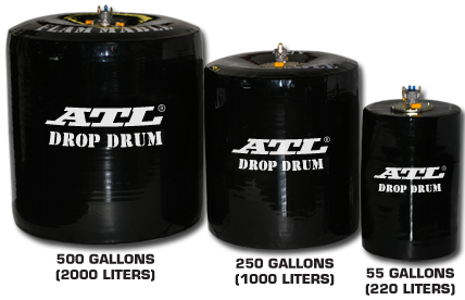

Do you not make use of blivets?
images
It seems to me almost any flat bed truck (or LAV or TLAV) could be turned into a bowser.  In fact you could carry both water an fuel on the same MLVW/MSVS.

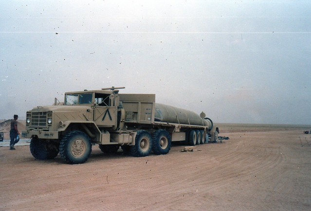

US army PAM on refueling and re-arming points
http://armypubs.army.mil/doctrine/DR_pubs/dr_a/pdf/atp3_04x94.pdf
and for you modellers
http://www.scalemates.com/products/product.php?id=121772
I know the US army has/had dedicated refueling units and even pipeline lying units
We do have the FSDS (Fuel Storage and Delivery System) that can comes with berms to keep spillage to the environment to a minimum
EDITED
Then again they are for static locations, I will try and post up some pics later of it....
