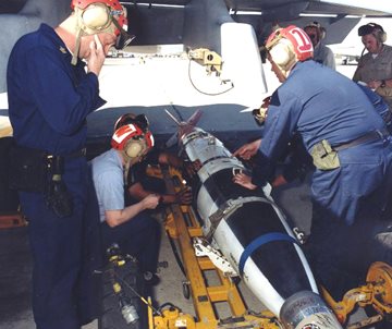

JDAM DAMASK​
Group: Bombs
Status: Cancelled
Also known as: JDAM HART
Origin:
Contractor/s: Boeing
Initial Operational Capability (IOC): 2007
Unitary Cost: $31,000
Production: 6,000
Ancile
Under DAMASK (Direct Attack Munition Affordable SeeKer) program the US military are trying to add an image seeker to the JDAM bomb achieving improved accuracy. DAMASK objective is to provide a CEP accuracy to JDAM about 3 meters. With such accuracy the JDAM bomb will be able to completely replace current laser guided bombs from the US inventory. The DAMASK seeker is valued at approximately $10,000-12,000 per unit. The US Navy expects to procure up to 6,000 JDAM HART (Hornet Real-Time Targeting) bombs through 2011.
The JDAM bomb nose-mounted DAMASK seeker will take an image from IR or visual sensors, synthetic aperture radar, satellite photograph or other source and will use it as a target template to self-guidance through the target. The target template can be loaded into DAMASK seeker before and during the flight from many different sources achieving an unprecedented operational flexibility. The uncooled IR DAMASK seeker activates itself and contributes to correct the bomb's trajectory when the target is at 2,000 meters away.
JDAM DAMASK
Group: Bombs
Status: Cancelled
Origin:
Production: 6,000

Think Merlin (81mm) Strix (120mm) Hellfire and Brimstone and SPEAR, and DAMASK (cancelled but the technology worked - alternatives suitable for the GWOT were available)
Again while all tools in the tool box - they are also subject to Enemy action - and can be negated.
The cost of the rocket, the booster, is
So the cost of a rocket capable of launching a small diameter bomb, with 50 to 150 lb of HE on a 150 km circuitous course against a fixed target is 43,000 + 40,000 = 83,000 USD? Against a moving target is 293,000 USD? What is the cost of maintaining a Combat Air Patrol of F18s? Of delivering hundreds of dumb 105s or even 155s? Of launching a ground assault with infanteers?
The cost comparison is not the cost of the bullets. It is the risk the target presents and the full cost of the other systems available to eliminate that risk.
