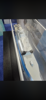

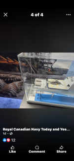

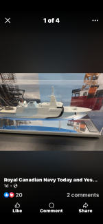

I haven’t seen any discussion on this yet. But these pics are from Seaspan’s pavilion (I didn’t take these, I believe they’re Noah’s). It’s purportedly the Seaspan pitch for the CDC program. I didn’t see much in the way of details included in the fb posting.

Looks like it's using a SPY radar as its main radar. I am not sure that meets the "made in Canada" criteria that is meant to move us away from the US for that specific ship type. I would have expected a European radar, either a SMART or a Thales NS110 type radar.

And I can just about guarantee that the flight deck depicted is too large.
But it doesn't lead to a hangar for the helo. If they have room in the specs displacement to make it big enough to land a Cyclone in an emergency, I can't blame them for that.

That Seaspan model was stated to be already out of date based on Seaspans new designs (CANSEC reporting... they just wanted to have a model there to show they were working on stuff I think).
Noah is reporting that CDC is upping the VLS requirement from 16. Which means likely 24 as they go in 8 packs. So its pretty much a regular guided missile frigate at this point and we can stop pretending its a corvette.
The new Sea Giraffe 4A has fixed arrays and I believe its going on the new Finish Pohjanmaa class corvette. As does the Germans with their Hendsolt TRS 4D.
Actually the Saab had a ship design for the CDC at CANSEC as well. They used the same mast design as for the Pohjanmaa class. The Saab Lightweight Integrated Mast
Its a fully composite mast design with a SG4A and SG 1X integrated into it (along with other stuff). If Canada wants to push the boundaries that's an interesting way to go.
