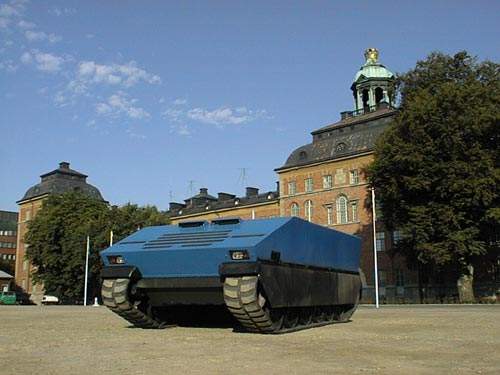

Tracked SEP
The tracked vehicles are fitted with rubber bandtracks rather than conventional steel link tracks. The bandtracks are lighter, quieter and have a longer operational life. The noise developed by the running gear is reduced by about 6dB. Bandtracks also have a lower rolling resistance. Band track technology has been used previously by Land Systems Hagglunds on the Bv206 articulated carriers which use short track length bandtracks.
In the SEP tracked vehicle the suspension is mounted on the underframe and not on the side frames, so the suspension is separated from the hull. A result of using a decoupled suspension and bandtracks is that the internal noise level is as low as 85dB which is sufficiently low to meet civilian vehicle noise requirements.
The decoupled suspension also provides a spaced outer layer which gives improved protection against mines. The SEP vehicle can withstand a 7kg TNT explosion under a track.
The company Ingenieurebureau Deisenroth (IBD), based in Germany, has developed a SEP protection kit that provides protection against advanced mines with explosively formed penetrators.
