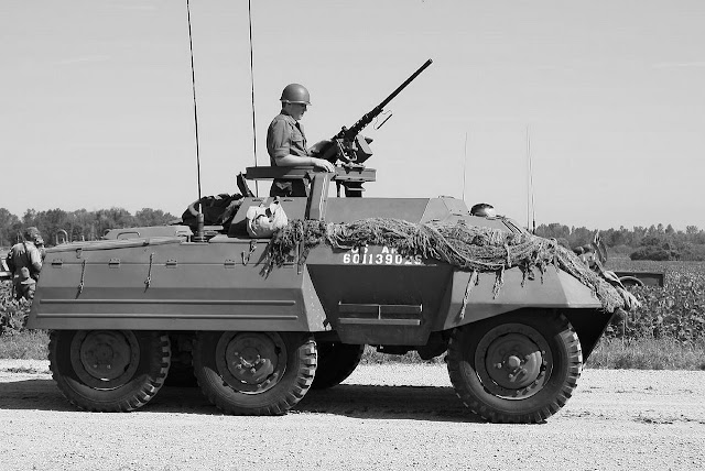

Yes the old deuces used the same tire and rim on all of it's wheels, including the dual wheel tandem version. these trucks had a simple and easy to use spare tire mount as well.
This was also based on the regular US army truck chassis of the day
